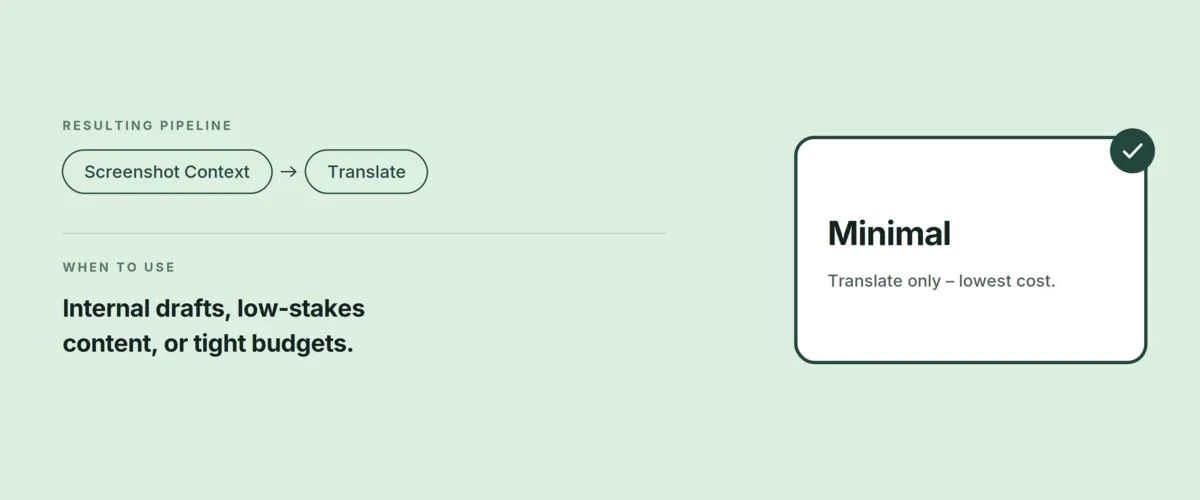

1. Minimal
The cheapest way to run a pipeline is not the same as raw AI translation. Even at this level, Screenshot Context stays on: the AI reads the screenshots your strings are tagged on and describes where each one appears, so the word “Follow” is understood as a button that subscribes to a profile rather than an instruction to carry out.
Then it translates. Two steps, no checks, lowest cost per string.
This level assumes your content can absorb an error – internal tooling, drafts, anything short-lived. And it has one hard dependency: if your strings aren’t tagged on screenshots, Minimal really is translation alone. Tag them, or move up a level.
Minimal level in the Crowdin AI Pipeline: screenshot context and translation

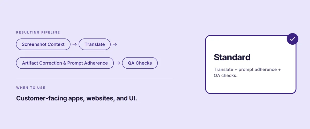

2. Standard
For customer-facing UI, the real challenge is adherence. Most AI errors happen because the model simply forgets the rules mid-translation.
Standard adds two steps after translation. Artifact Correction & Prompt Adherence sends an additional request to AI, checking the translations against the instructions your Translate step used and fixing any that drifted. It reuses what you already wrote there, so your glossary terms and brand rules live in exactly one place. QA Checks then catches what a linguistic review misses: broken tags, mismatched placeholders, damaged formatting.
The best part is that the AI corrects itself. There is nothing to resolve manually – you see the already edited output, ready for use.
Standard level in the AI Pipeline: screenshot context, translation, artifact correction and QA checks

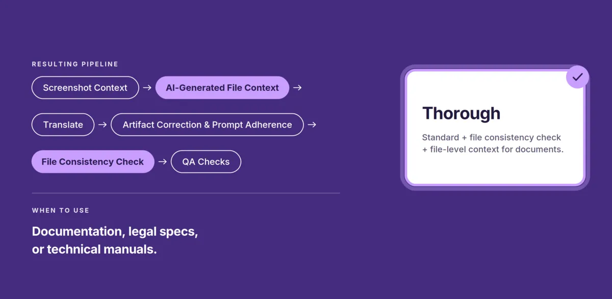

3. Thorough
Thorough is built for long-form content, where consistency across a whole document matters more than the cost of any single string. It wraps two more steps around what Standard already runs.
AI-Generated File Context runs before translation, reading the file as a whole so the AI isn’t working string by string in a vacuum. File Consistency Check runs after, comparing new translations against what is already in the file, so an update doesn’t read like an update.
Both are scoped to file patterns, so they only touch the content that needs them:
  • When to use it: narrative or technical flow – documentation, help articles, or legal specs.
  • When to skip it: simple resource files, like a list of unrelated app buttons, where nothing depends on anything else.
By reading the other 90% of a file, this level ensures the new 10% maintains a unified voice throughout.
Thorough level in the AI Pipeline: all Standard steps plus file context and file consistency check
