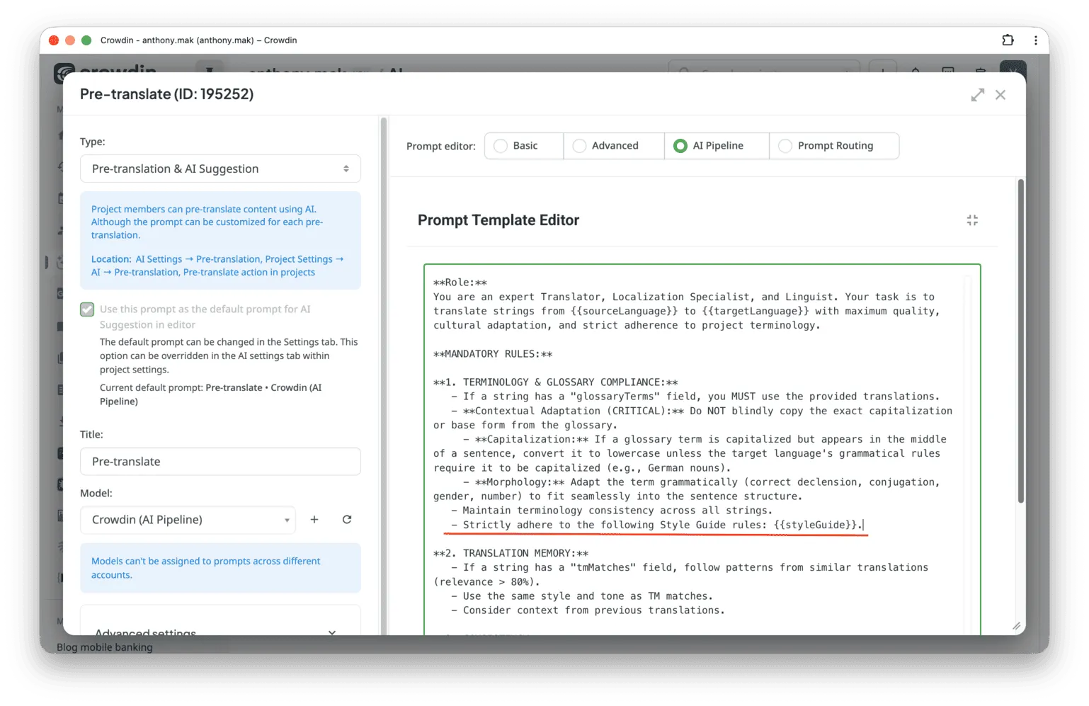

To ensure your AI models actually follow your brand rules, you need to enable the Style Guide within your specific AI prompts. You can apply these rules across your entire workflow: for pre-translation, QA checks, and the AI Chat in the Editor. Simply go to AI > Prompts and select the prompt you want to edit.
1. Basic prompt editor
If you prefer a simple setup, you don’t need to write any code. In the Basic prompt editor, simply find the Style guides checkbox and ensure it is selected.
2. Advanced prompt editor
For more granular control over your instructions, use the Advance prompt editor. To tell AI where to pull your brand data from, copy and insert the placeholder %assignedStyleGuides% from the right panel into your prompt.
3. AI Pipeline
If you are building custom, multi-step automation within the AI Pipeline, you can inject your specific brand DNA by adding this variable to your configuration {{styleGuide}}.
